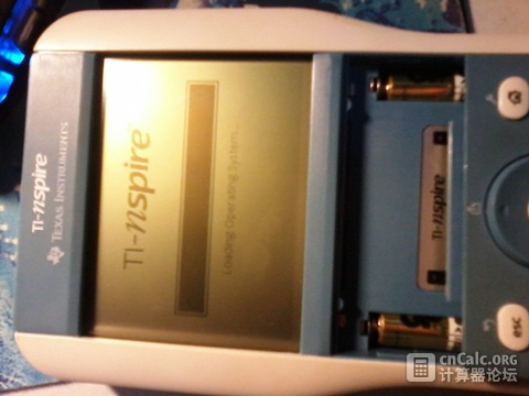

[Nspire] 购得一款os1.3.几的nspire clickpad,想更新的时候卡在这里再不动,请问有何解决办?
 楼主| 发表于 2013-11-7 17:27:58 | 显示全部楼层
诗诺比 发表于 2013-11-7 16:52
OS TI-Nspire™ (v 2.1.0)
http://tiplanet.org/forum/archives_voir.php?id=1898
又死在这里了。
啊啊啊啊
啊啊啊啊
发表于 2013-11-7 20:51:39 | 显示全部楼层
549597890 发表于 2013-11-7 16:42
没有那个标志。
但是boot2确实太低了点。另外这是目前唯一能刷进去启动的系统。按照1.7上的ndless2教程装 ...
You still have the old 1.1 Boot2.
It means that installing OS 2.1 will crash the calculator, and that OS 3.0 and later are going to be rejected.
You should install Boot2 1.4.
This is done by sending any full OS (not a light version generated with TNOC) between 1.4 and 2.0.
 楼主| 发表于 2013-11-7 22:19:19 | 显示全部楼层
It means that installing OS 2.1 will crash the calculator, and  ...
Finally it got the boot1.4 and work at  3.*os,maybe there is something wrong with my first usb link which give the reason to my first failure.  thank U so much !
