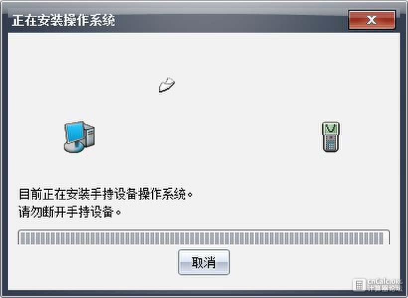

如图。到这里后再不动了
卡住不动
卡住不动
 楼主| 发表于 2013-11-4 22:28:35 | 显示全部楼层
计算器上什么反应都没有‘

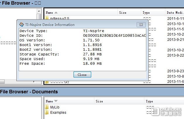

Check and report the current version of the calculator, please :)
 楼主| 发表于 2013-11-5 09:39:12 | 显示全部楼层
很糟糕的是我用格式化的那个菜单把系统清除了,现在只有boot1 1.1.8916
以及boot2 1.1.8981

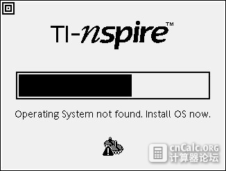

549597890, is there any strange sign in the top left-hand corner of the screen when you turn on the calculator?
Anything like this?
 楼主| 发表于 2013-11-6 00:01:43 | 显示全部楼层

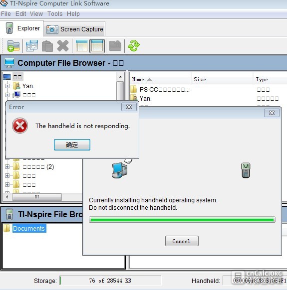

很抱歉昨晚说错了一件事实:我的屏幕左上没有水瓜设备那种标志。不过我在刷1.1系统的时候遇到跟他一样的问题,刷1。3或者更高时候会遇到如下图所示
 楼主| 发表于 2013-11-7 00:46:52 | 显示全部楼层
critor 发表于 2013-11-6 01:22
Ok, then you have a prototype and it's going to reject all production OSes available on education.ti ...
如图
like this
 like this
发表于 2013-11-7 01:50:16 | 显示全部楼层
This is a generic error message.
So nothing really wrong for now: just reboot the calculator and try again until it works or you get a specific error message.
