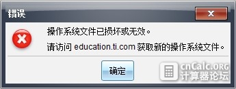

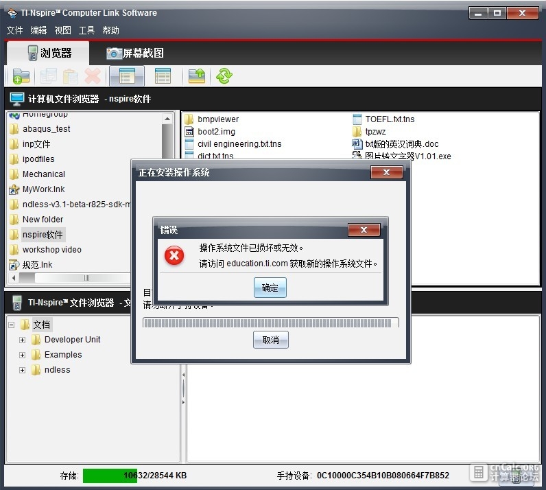

刚从淘宝淘了个二手的
nspire cas touchpad
想升级3.1系统安装ndless
结果升级总失败
请求大神赐教!!
系统版本是2.0.0.851
其中界面也是那种比较旧的
如图
下图是设备的详细信息
最终的错误提示结果如下图

 楼主| 发表于 2013-8-18 16:24:01 | 显示全部楼层
nbzwt 发表于 2013-8-18 16:20
估计是Not For Sale,版本号低于2.0.0.1188应该就是不正常的……
楼主多少买的,如果200以上就亏了……
我重新删除系统和数据
EE+doc+enter+on
然后刷了个3.1的系统
到时刷新成功了
不过按键乱了
比较费劲……
(谢谢上楼的热情!!3Q!)

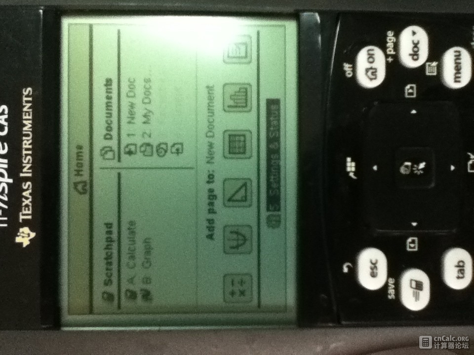

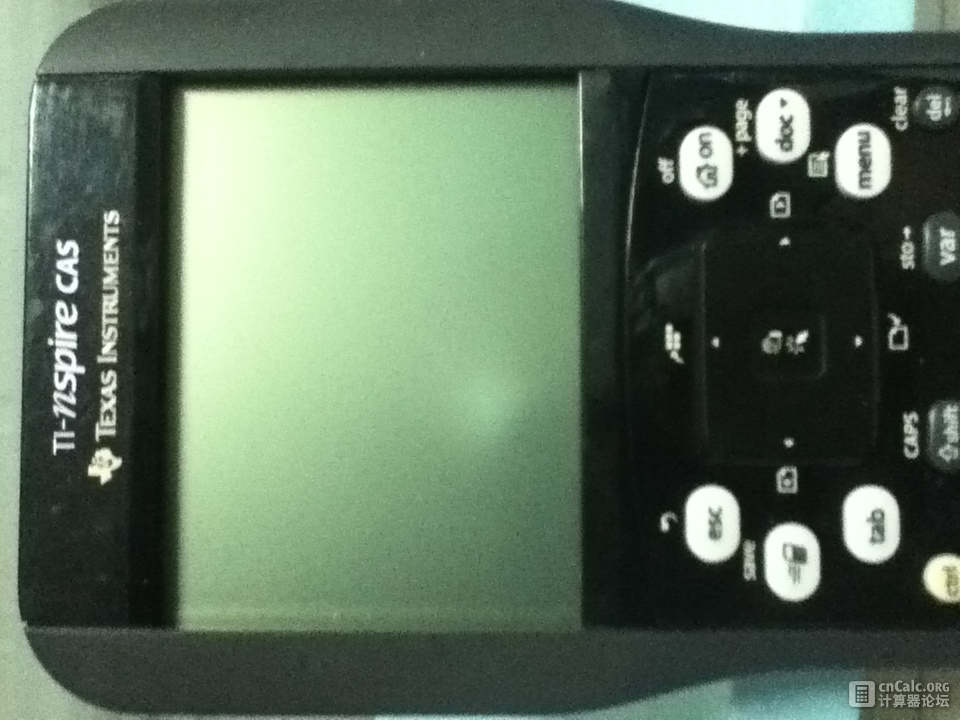

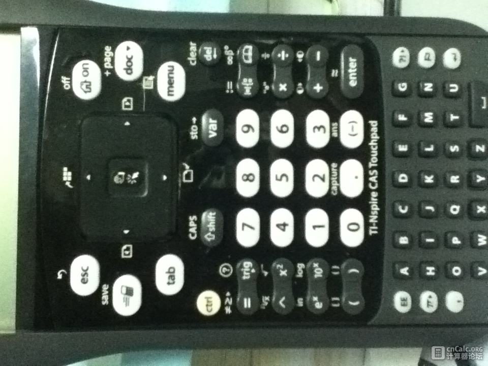

 楼主| 发表于 2013-8-18 17:22:46 | 显示全部楼层
nbzwt 发表于 2013-8-18 17:08
请务必发张图啊,本人表示十分好奇。我是DVT爱好者,便宜点卖给我也可以啊
我这个是touch pad
那个什么芯片是不可写的好像
随意了,给你发个图就是了~
貌似这个版本也不多。正在进一步了解中~
待我再仔细研究一下,嘿嘿
背面
背面
键盘
键盘
屏幕
屏幕

发表于 2013-8-18 18:30:22 | 显示全部楼层
Hi,
The Boot1 and Boot2 might be using the development RSA keys instead of the production ones, and then will reject every production Operating System.
We've been able to successfully upgrade TI-Nspire ClickPad DVT1.2/DVT2.0 prototypes because the NOR chip wasn't write-protected and so we could reflash the Boot1.
Not sure if it will still be the case here - we would need some pictures of the motherboard.
Adapting Ndless 2.0 for your 2.0.0.851 Operating System should be possible. But we will first need to get an image of the Operating System. Could you try the tool mentionned on Omnimaga?
http://www.omnimaga.org/index.php?topic=16422.msg295920#msg295920

 楼主| 发表于 2013-8-18 18:46:04 | 显示全部楼层
nbzwt 发表于 2013-8-18 18:33
Now, keys were missed up.
sorry to tell you that I have reflashed it to the most highest version
only one little point is need to say is
I make it to edition 3.1 which can use the ndless
may be the only thing i can do is to wait for your help because i almost have no professional knowledge except c++ or c
thank you for your reply!!
