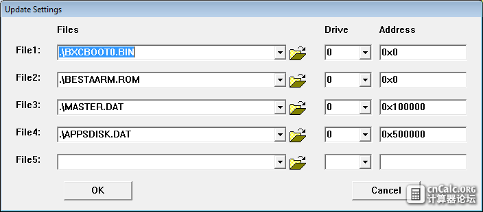

HP Prime firmwares are made of multiple files.
  • BXCBOOT0.BIN
  • BESTAARM.ROM
  • MASTER.DAT
  • APPSDISK.DAT
