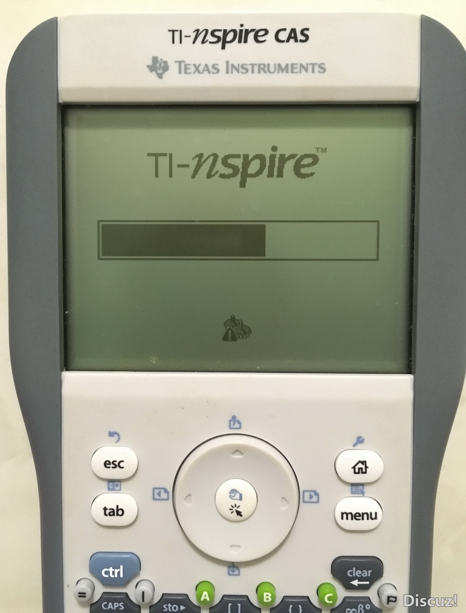

我的一个Cas也是刷到1.7版本正常,再升级到3.1.0.192后也是无法启动,停止在一半的画面。怎么解决?
发表于 2017-5-24 21:47:51 | 显示全部楼层

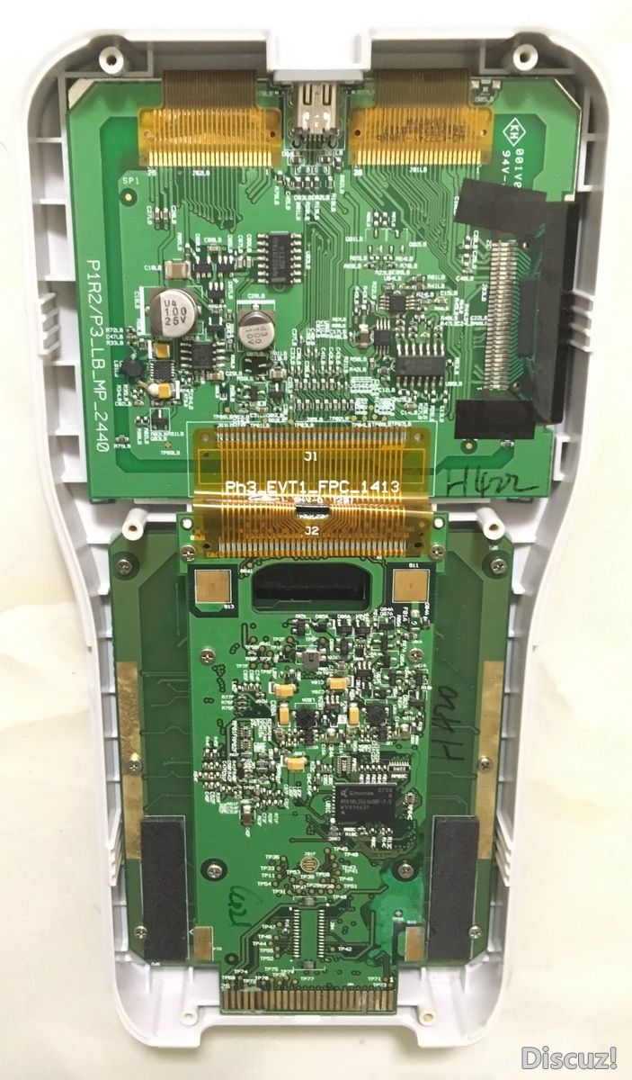

拆开壳子后再数据线上看到了EVT的字样。原来什么版本忘记了,我升级到1.7版本时还是正常的。升级到3.1后启动就如楼主这样的画面停止了。怎么解决呢?
发表于 2017-5-24 22:22:56 | 显示全部楼层
TTL接口位置在哪里?
Apparently, the new 3.1 OS tried to update your Boot2 1.4 to version 3.0.1, an the update did fail. :(
So no valid Boot2 anymore, your calculator is now totally unusable. :(
You need to reflash a valid Boot2 image.
USB isn't functionnal in such an advanced bricking state, so you'll need to connect a TTL interface to the Dock/J01 connector :
