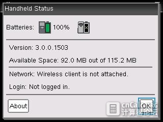

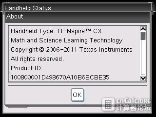

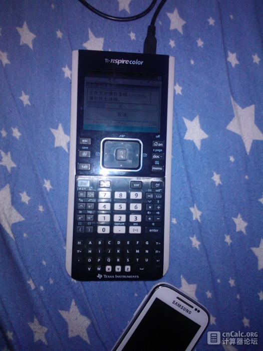

发表于 2013-10-9 19:43:21 | 显示全部楼层 |阅读模式
一个月前在X宝买的原型机。
3.0.0.1503系统。
Boot1:3.0.0
Boot2:3.0.0
没有开发机标识。
型号显示为TI-Nspire TM CX
不过,开机画面还是绿色进度条。
只能在插USB的情况下开机,我推测电池损坏。
ColorEVT.rar (13.18 MB, 下载次数: 35)
文件系统和OS都已经导出,请看附件。

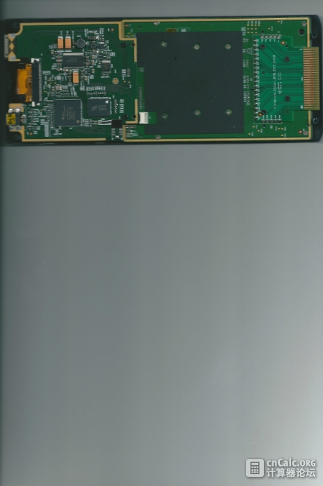

 楼主| 发表于 2013-10-9 20:31:22 | 显示全部楼层
我最清楚的成像设备就是这个扫描仪了。
 楼主| 发表于 2013-10-9 20:46:26 | 显示全部楼层
ASIC:ET-NS2010A-0 T6UJ1XBG-0001
Memory:OHA98  JW378
 楼主| 发表于 2013-10-9 20:53:14 | 显示全部楼层
感谢去年朔雪的帖子,我没把主板连接口拆坏。
初步断定这台原型机就是去年出现过的型号,甚至更早一些。

充了一晚上电,终于能不插USB开机了。
 楼主| 发表于 2013-10-10 09:07:32 | 显示全部楼层
{:019:}几分钟电量掉到75%
发表于 2013-10-10 22:12:39 | 显示全部楼层
Hi!
Nice find - thank you for the pictures and the dump.
Your 3.0.0.1503 is a development OS which was built on 8th February 2011.
The 3.0.0 Boot1 and Boot2 flashed in your TI-Nspire Color are development images: they'll only accept to run development OSes and not production OSes released on TI website.

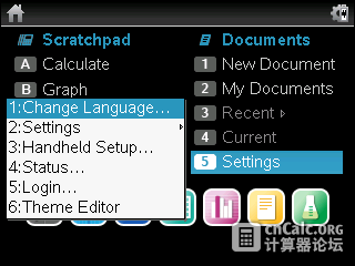

Note that the oldest one, 3.0.0.1045 is interesting as it includes an official builtin theme editor which was removed on later versions:
Source: http://tiplanet.org/forum/viewtopic.php?t=11089

To install production OSes on your TI-Nspire Color, you'll either have to:
- Reflash the Boot1: this is possible as the Boot1 here is not in the proprietary ET-NS2010A-0 ASIC but on a publicly documented external Flash-NOR chip by MXIC you'll find on the other side of the board behind the J04 connector. We could achieve this on TI-Nspire ClickPad prototypes. You'll need to adapt our code for the different chip.

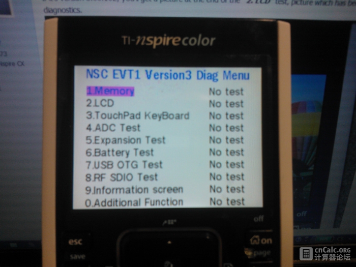

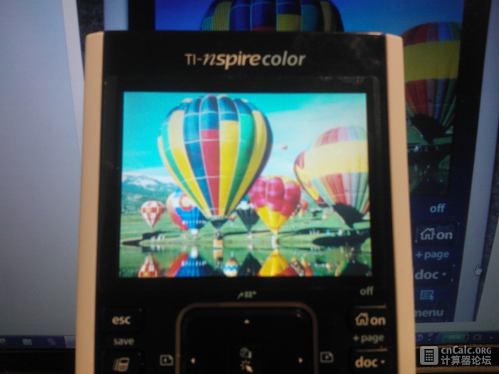

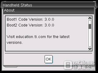

Could you check your TI-Nspire Color Diagnostics version?
Diagnostics is started by holding the Esc+Menu+Minus keys while pressiong reset.
If it's version 3.00.102, you'll get a picture at the end of the "2. LCD" test, picture which has been removed on production diagnostics.
 楼主| 发表于 2013-10-11 18:45:24 | 显示全部楼层
Diagnostics is started by holding the E ...
发表于 2013-10-11 19:14:58 | 显示全部楼层
Thanks. :)
Is it version 3.00.102 too? Version number can be found in "8. Information Screen".
