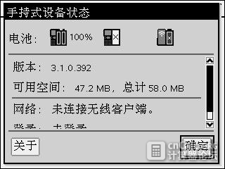

发表于 2013-7-20 11:54:36 | 显示全部楼层
_14522 发表于 2013-7-20 09:43
重装了3.1的OS后已解决。只是貌似可用空间多了很多出来。。。
58.0MB!!!!!!!!!!!!!!!!!!!!!!!!!!!!!!!!!!!!!!!!!!!!!!!!!!!!
发表于 2013-7-20 12:10:35 | 显示全部楼层
各种出错啊,你的难道是64MB的Nand?
 楼主| 发表于 2013-7-20 16:53:08 | 显示全部楼层
不清楚,本身是二手买的,然后今天处理给同学。所以帮他重弄了遍系统,反正我不知道怎么回事就是了
发表于 2013-7-20 18:52:27 | 显示全部楼层
64MB ? Oh great!{:thumbsup:}
Could we get a real photo of the calculator on this screen?
发表于 2013-7-20 19:30:17 来自手机 | 显示全部楼层
critor这么一说我才想到了可能是photoshop处理过的
 楼主| 发表于 2013-7-20 23:01:26 | 显示全部楼层
critor 发表于 2013-7-20 18:52
64MB ? Oh great!
As I said upstairs , I sold it to my classmate . Now this calculator is not near me . I had told my classmate to take a photo , so I'll upload the photo unless tomorrow .
by the way , now we're on vacation , I cant see him everyday , maybe you'll wait for days.
but i swear this photo is true. one reason is that i am unable to use photoshop .........
it's my first time to speak foreigner, just ignore grammar mistakes. and i am curious how you can read Chinese articles.
发表于 2013-7-25 19:46:01 | 显示全部楼层
我晓得为啥出错了,这估计是个加了64MB内存的试作品。
I already knew that why 【_14522】's nSpire had a problem because I guess it is a PROTOTYPE with 64MB NAND memory.
 楼主| 发表于 2013-7-25 20:09:01 | 显示全部楼层
I already knew that why 【_14522】's nSpire had  ...
真的吗,为什么是64MB,正常的版本是什么
really? why ? how about usual version?
发表于 2013-7-28 13:06:41 | 显示全部楼层
A RETAIL version TI-nSpire with a monochrome screen (Clickpad/TouchPad) has 20MB NAND Flash memory. Normally, installing OS will cost about 6~9MB. The avaliable space is about 13MB.
I think your nSpire may be a PROTOTYPE (nSpire CAS TouchPad EVT)
