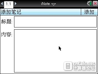

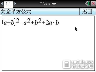

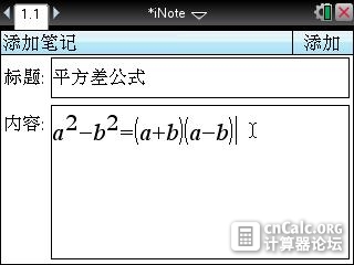

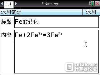

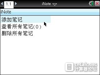

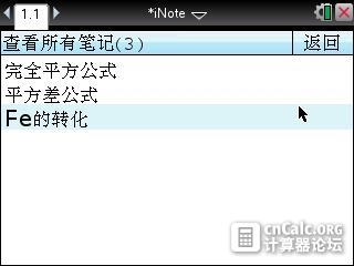

程序名称: iNote
作者: imath
大小(K): 4
更新日期: 今天

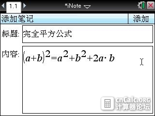

iNote现已发布。
通过使用iNote,你可以记录任何灵感,可以是文学的,亦或是科学的。或者仅仅当做是一个备忘录,或者仅仅是当做一个提醒事项,日程安排表。并且可以集中查看,集中管理。记录的条数没有上限。使用鼠标控制,若没有鼠标,轻按tab可以呼出鼠标。具有自动保存功能,只需退出程序时选择保存文档即可。
此APP已针对CX CAS优化。
屏幕截图:
iNote.tns
3.04 KB, 下载次数: 24

Good design, but you have to check if you are in the first "frame" (where you have two 2dEditors) when typing on the keyboard because wherever you are, keys pressed gets added to the text box.
Also, I see you don't use classes nor screen. It would make your code much much simpler and efficient (especially all your If with the "Where" variable...)
Take a look here : http://inspired-lua.org/index.ph ... e-a-screen-manager/
As well as http://compasstech.com.au/TNS_Au ... g/script_tut11.html

How did you know that I used the var "Where"?
As the matter of fact,I used a class called "ui"
and I used it in this way:
if Where == 0 then
ui:home(gc)
elseif Where == 1 then
ui:addnote(gc)
elseif ...
end
Meanwhile,the botton in the RIGHTest and the UPest zone is based on a class called okbutton.
There is actually a bug as you said.I wish I could fix it sooner or later.
In future I also want to add some functions such as passcode.
I appreciate it that you helped me.

But it's easier for us to help you and for you to debug to get a no-password version at first. Then, for a release, you could put a password if you would like.
Anyway, the use of "Where" and things like that means that you don't use screens and it's a pity since it's much better :) But yeah, your code is not bad at all :)
For the 2DEditor bug, just move it off screen and nil it when yo'ure out of the frame, it should work.

as with that bug,in fact,I think setfocus(false) is enough.
