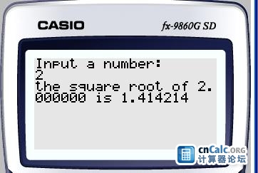

输入输出测试
  1. int main()
  2. {
  3.     char buf[64];
  4.     double a;
  5.
  6.     puts("Input a number:");
  7.     gets(buf,64);
  8.     a = atof(buf);
  9.     sprintf(buf,"the square root of %f is %f",a,sqrt(a));
  10.     puts(buf);
  11.
  12.     return 0;
  13. }

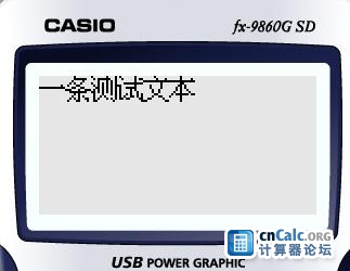

2.汉字库读取测试(读入一个汉字文本并使用HZK12.df输出)
  1. #include <stdio.h>
  2. #include <fxlib.h>
  3. #include <string.h>
  4. #include <stdlib.h>
  5. typedef FONTCHARACTER fontc;
  6. int HZK_file = 1;
  7. void char_to_font(char * cfname,fontc * ffname)
  8. {
  9.     int i,len = strlen(cfname);
  10.     for(i=0; i<len ;++i)
  11.         ffname[i] = cfname[i];
  12.     ffname[i]=0;
  13. }
  14. void font_to_char(fontc *ffname,char *cfname)
  15. {
  16.     int i = 0;
  17.     while((cfname[i]=ffname[i])!=0)++i;
  18. }
  19. void draw_picture(int x,int y,int width,int height,int mode,unsigned char * p)
  20. {
  21.     DISPGRAPH dg;
  22.     dg.x                    = x;
  23.     dg.y                    = y;
  24.     dg.GraphData.width      = width;
  25.     dg.GraphData.height     = height;
  26.     dg.GraphData.pBitmap    = p;
  27.     dg.WriteModify          = mode+1;
  28.     dg.WriteKind            = 0;
  29.     Bdisp_WriteGraph_VRAM(&dg);
  30. }
  31. void print_ch_char (unsigned char c1,unsigned char c2,int x,int y)
  32. {
  33.     unsigned char mat[24];
  34.     int sec,pot;
  35.     sec = c1-0xa0;
  36.     pot = c2-0xa0;
  37.     Bfile_ReadFile(HZK_file,mat,24,(94*(sec-1)+(pot-1))*24l);
  38.     draw_picture (x,y,12,12,0,mat);
  39. }
  40. int main()
  41. {
  42.     unsigned char    buf[64];
  43.     fontc            file_name[64];
  44.     int              text_file,file_size,bytes_read,i;
  45.
  46.     Bdisp_AllClr_DDVRAM();
  47.
  48.     char_to_font("\\\\fls0\\HZK12.df",file_name);
  49.     HZK_file = Bfile_OpenFile (file_name,0);
  50.     if (HZK_file < 0)
  51.     {
  52.         puts("cannot open HZK file");
  53.         return -1;
  54.     }
  55.
  56.     char_to_font("\\\\fls0\\TEST.txt",file_name);
  57.     text_file = Bfile_OpenFile (file_name,0);
  58.     if (text_file < 0)
  59.     {
  60.         puts("cannot open text file");
  61.         return -1;
  62.     }
  63.
  64.     file_size  = Bfile_GetFileSize(text_file);
  65.     bytes_read = Bfile_ReadFile (text_file,buf,file_size,0);
  66.     Bfile_CloseFile(text_file);
  67.     buf[bytes_read] = '\0';
  68.
  69.     for(i=0;buf[i];i+=2)
  70.     {
  71.         print_ch_char(buf[i],buf[i+1],i*6,0);
  72.     }
  73.
  74.     Bfile_CloseFile(HZK_file);
  75.     return 0;
  76. }

 楼主| 发表于 2013-5-2 12:52:27 | 显示全部楼层
angrybird 发表于 2013-5-2 00:34
9750GII提示“\\fls0\TEST.C:6:'puts' is undefined”
没有包含头文件~
想用puts必须#include <stdio.h>
1L的例子好像忘记包含了...
发表于 2013-5-2 12:53:14 | 显示全部楼层
解决了
原来是缺了相关的头文件。
发表于 2013-5-2 12:54:13 | 显示全部楼层
TEST.c完美通过9750GII测试。
