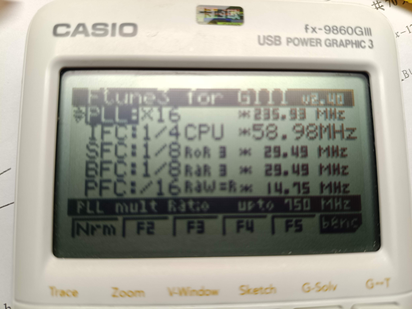

How to use
Main screen
FLL:x900          * 14.75MHz
PLL:x16           *235.93MHz
IFC:1/4  CPU      * 58.98MHz
SFC:1/8  RoR 3    * 29.49MHz
BFC:1/8  RaR 2    * 29.49MHz
PFC:/16  RaW =R   * 14.75MHz
messeage area / benchmark score
