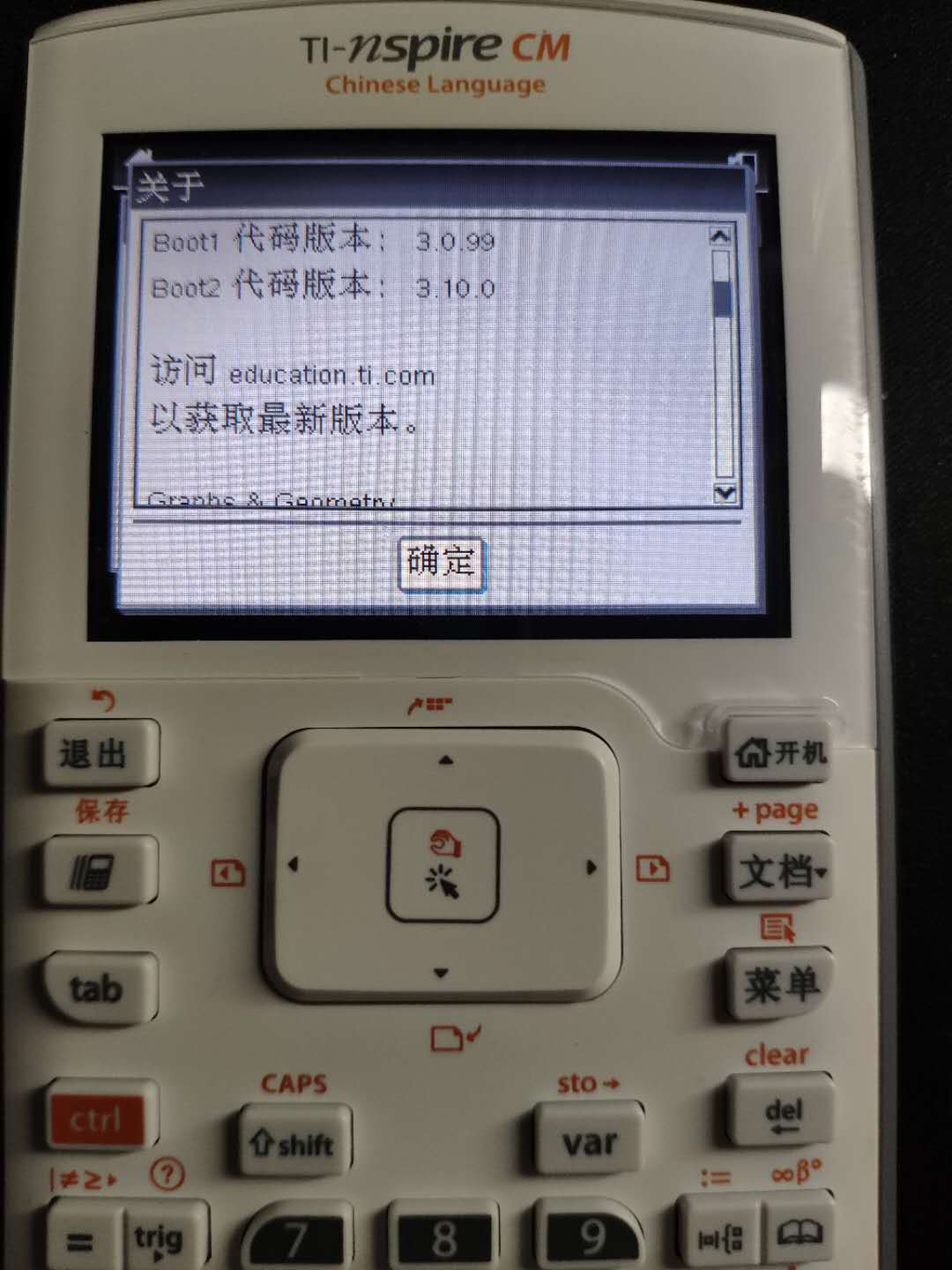

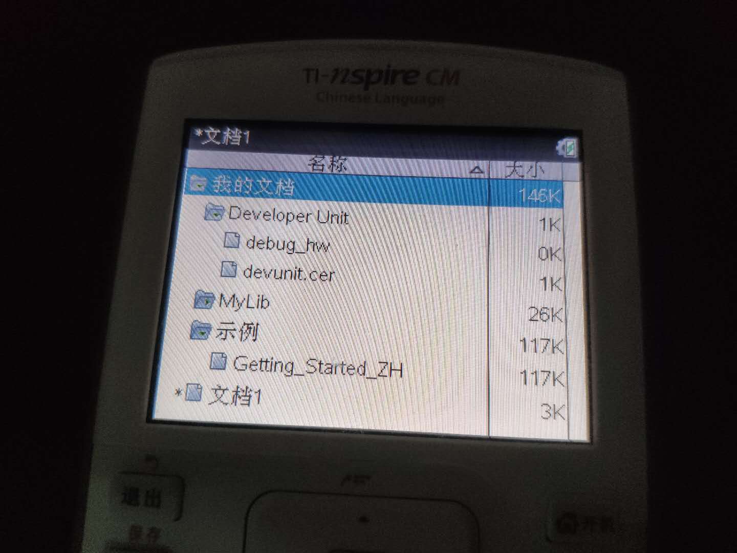

设备详情如下,我的文档里面还有类似开发者文件
 楼主| 发表于 2020-3-5 14:02:21 | 显示全部楼层
看旧贴了解到貌似工程机不能升级系统

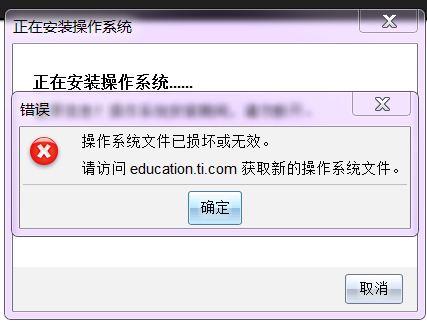

 楼主| 发表于 2020-3-5 14:26:49 | 显示全部楼层
亲测不能升级系统(电脑提示系统文件损坏或无效),安装ndless直接重启,所以有没有什么方法升级到正常系统?

发表于 2020-3-7 06:21:20 | 显示全部楼层
@1172884664
Your CM is in development mode as reported by the little square in the top left-hand corner of the screen during the boot.
In this state it won't accept a production CM OS.
Try renaming the Developer Unit folder to something else.
This should switch your calculator back to production mode on the next boot.
You might need to remove the current OS manually through the maintenance menu to complete this.
It would be nice backuping and sharing your current CM OS before if you can; we never dumped a CM development OS so far.

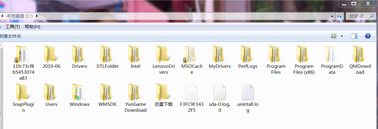

This is "C:\" of the computer.There is no OS backup.

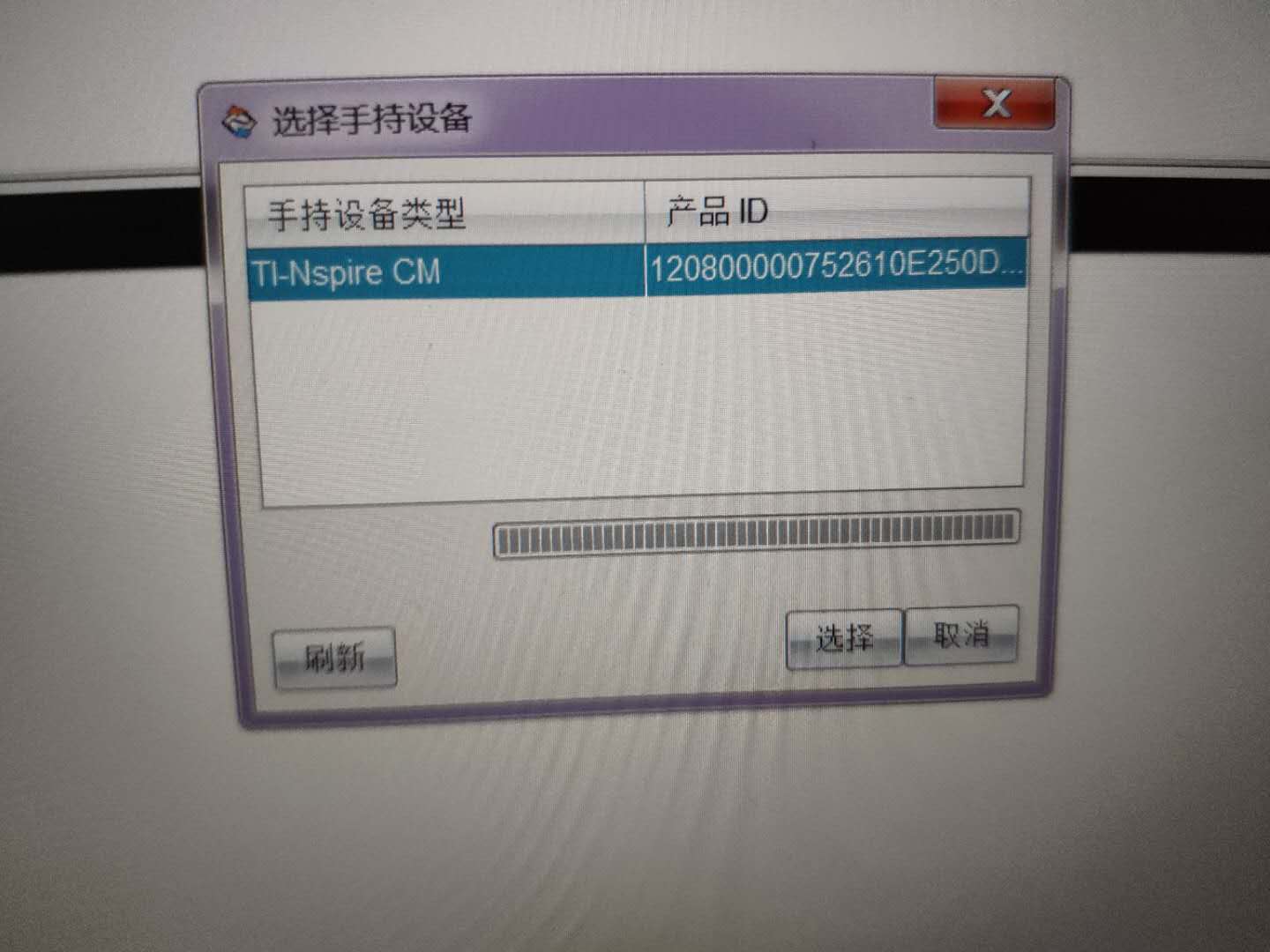

 楼主| 发表于 2020-3-19 09:45:43 | 显示全部楼层
@critor

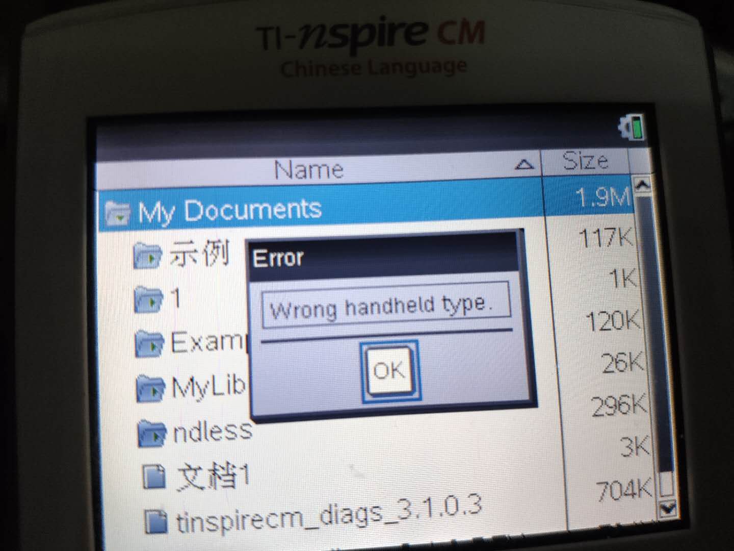

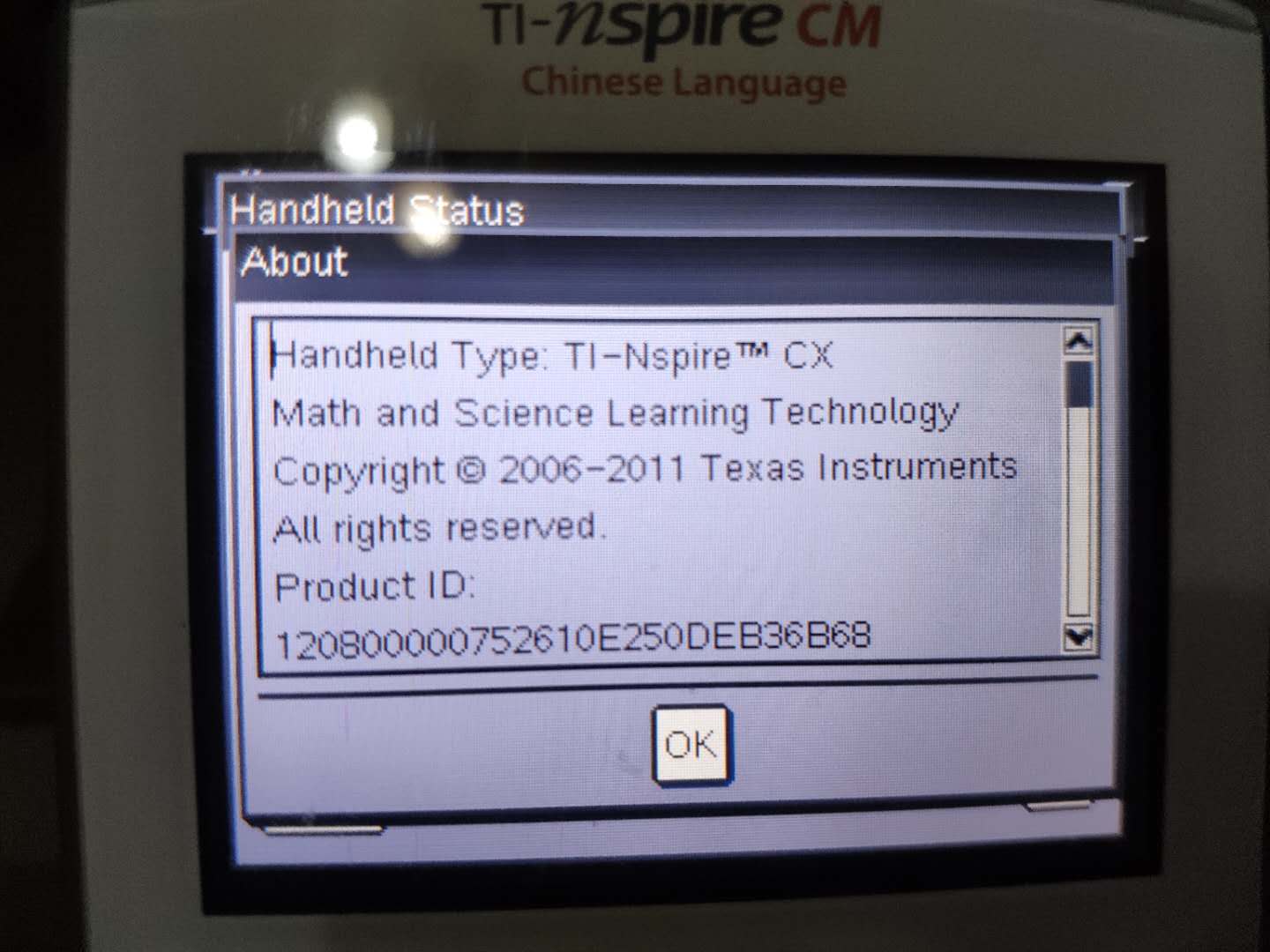

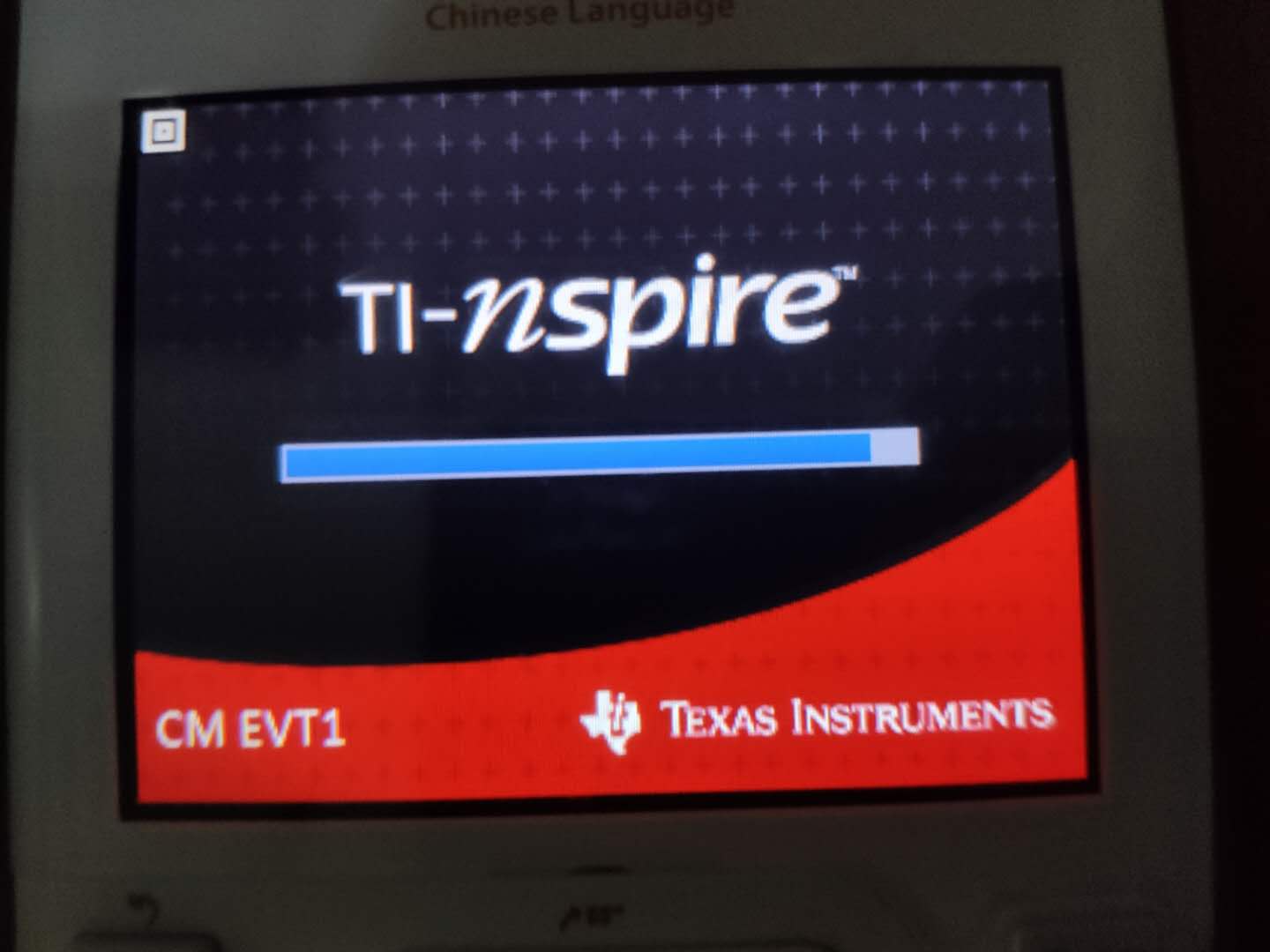

I was confused by a discovery. It is CX on the calculator, and it is CM on the computer.Development CM display "Wrong handheld type" when I send OS to normal CM or CX. 微信图片_20200319093946.jpg
发表于 2020-3-19 20:33:06 | 显示全部楼层
Thanks for your reply. :)
According to the productID starting with 12, your prototype is a CM.
Is the receiving CM a normal calculator ?
If it's been modded to run a CX/CAS OS, you won't be able to send a CM OS to it.
 楼主| 发表于 2020-3-19 22:41:21 | 显示全部楼层
Receiving CM is a normal CM ,and I send to a nlaunch cx.Both display"Wrong handheld type".
发表于 2020-3-20 01:08:24 | 显示全部楼层
Thanks. Unfortunately, Nlaunch is rejecting all OS transfers.
So if the receiving CM has been setup with Nlaunch, sending an OS to it won't work.

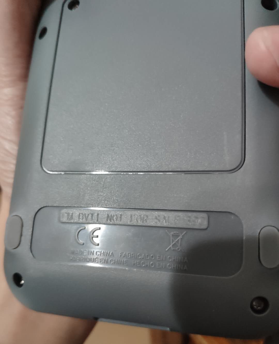

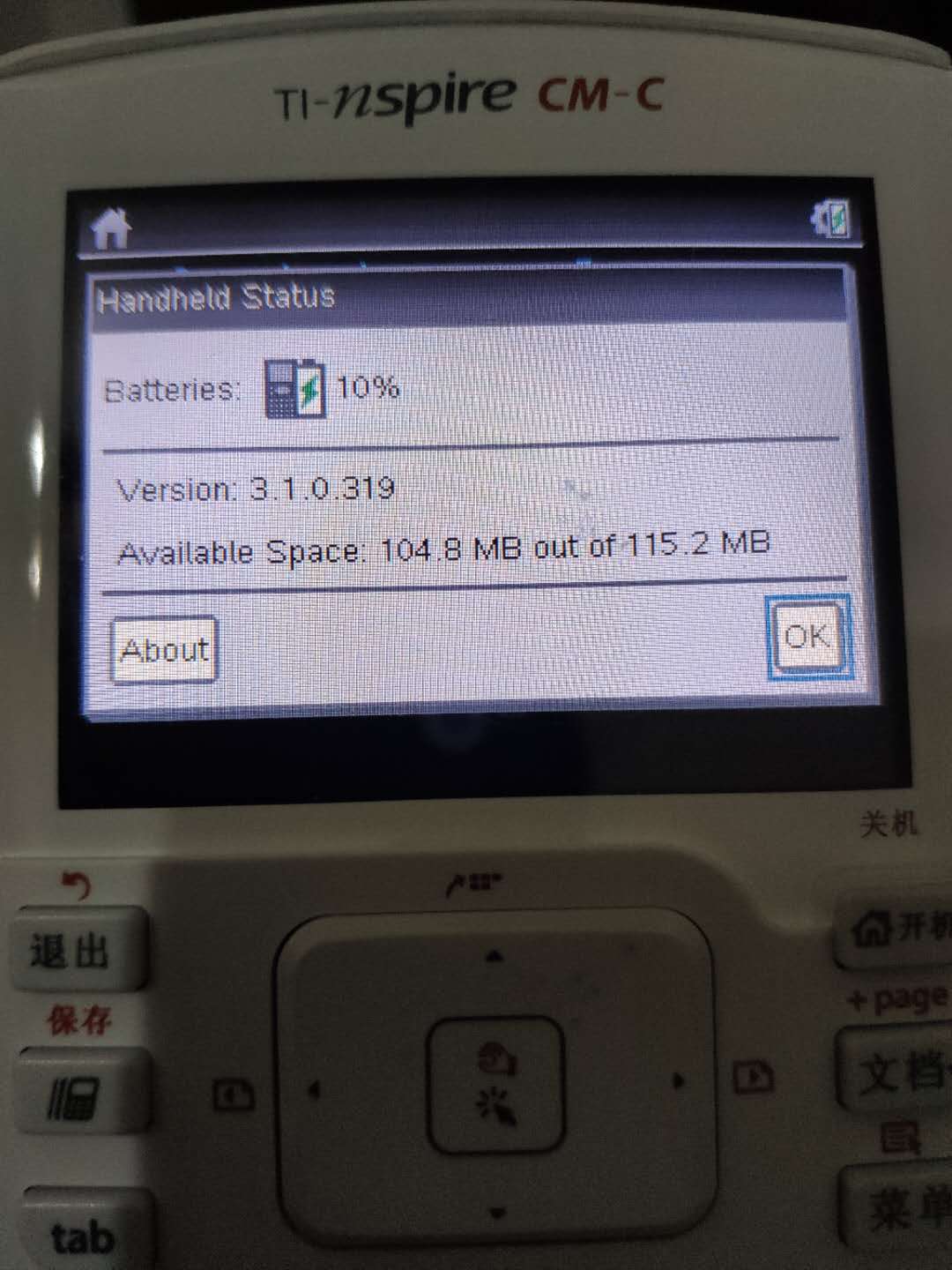

@critor

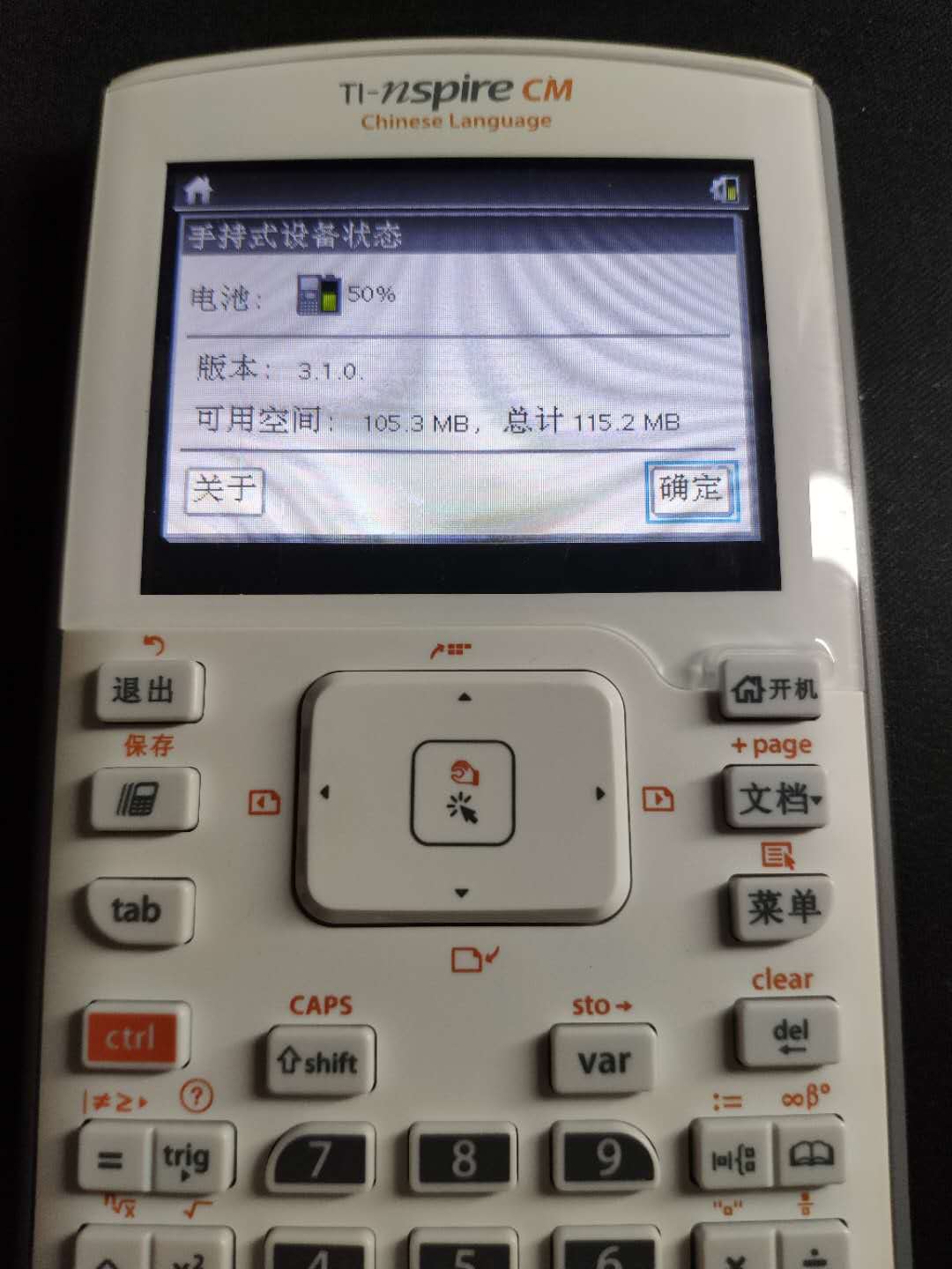

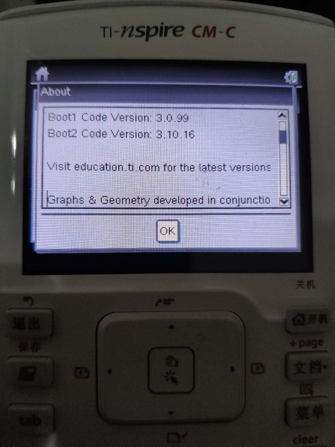

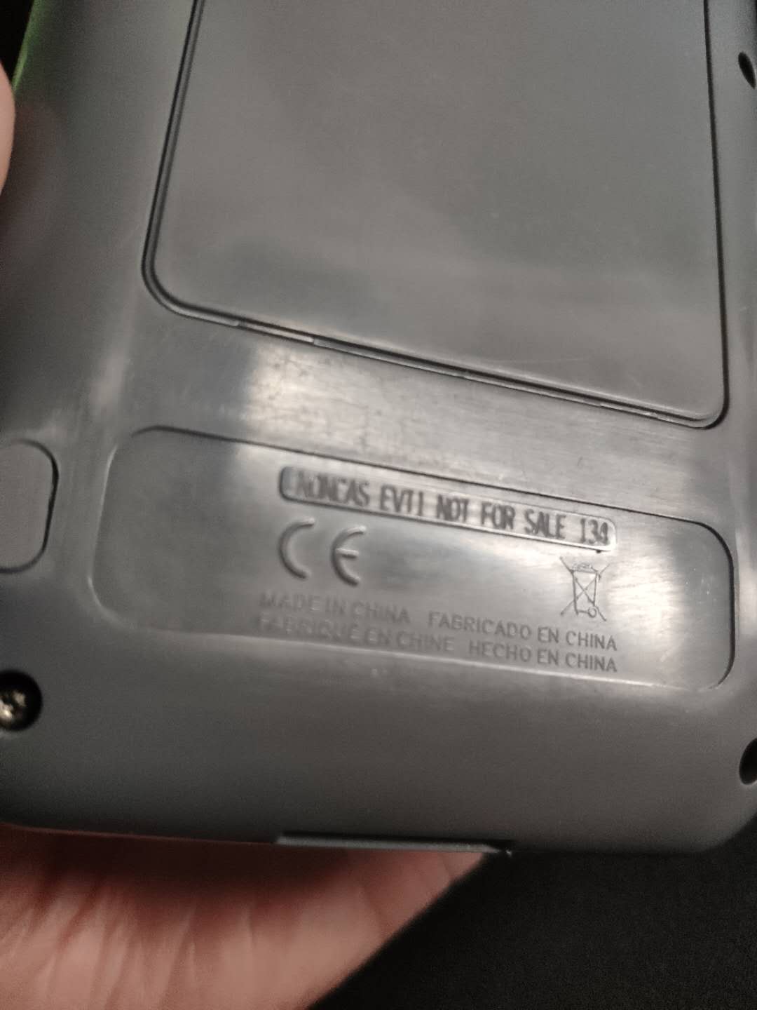

I got a CM DVT1.The OS version is 3.1.0.319. Do you want OS?
发表于 2020-4-25 07:33:59 | 显示全部楼层
Yes, if you can. :)
Thanks.
