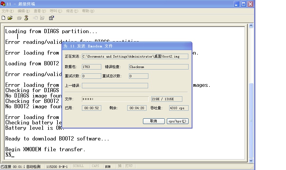

必须用XP系统传,才能成功
以下是XP系统的

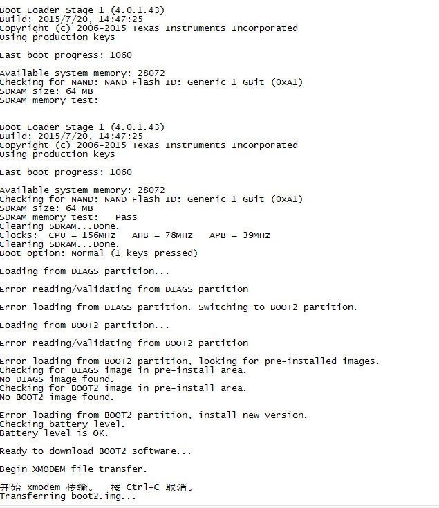

 楼主| 发表于 2019-3-21 13:19:14 | 显示全部楼层
Boot Loader Stage 1 (4.0.1.43)
Build: 2015/7/20, 14:47:25
Copyright (c) 2006-2015 Texas Instruments Incorporated
Using production keys
Last boot progress: 1
Available system memory: 28072
Checking for NAND: NAND Flash ID: Generic 1 GBit (0xA1)
SDRAM size: 64 MB
SDRAM memory test:   Pass
Clearing SDRAM...Done.
Clocks:  CPU = 156MHz   AHB = 78MHz   APB = 39MHz
Boot option: Maintenance
Loading from DIAGS partition...
Error reading/validating from DIAGS partition
Error loading from DIAGS partition. Switching to BOOT2 partition.
Loading from BOOT2 partition...
Error reading/validating from BOOT2 partition
Error loading from BOOT2 partition, looking for pre-installed images.
Checking for DIAGS image in pre-install area.
No DIAGS image found.
Checking for BOOT2 image in pre-install area.
No BOOT2 image found.
Error loading from BOOT2 partition, install new version.
Checking battery level.
Battery level is OK.
Ready to download BOOT2 software...
Begin XMODEM file transfer.
开始 xmodem 传输。  按 Ctrl+C 取消。
Transferring boot2.img...
等了半个小时也没反应

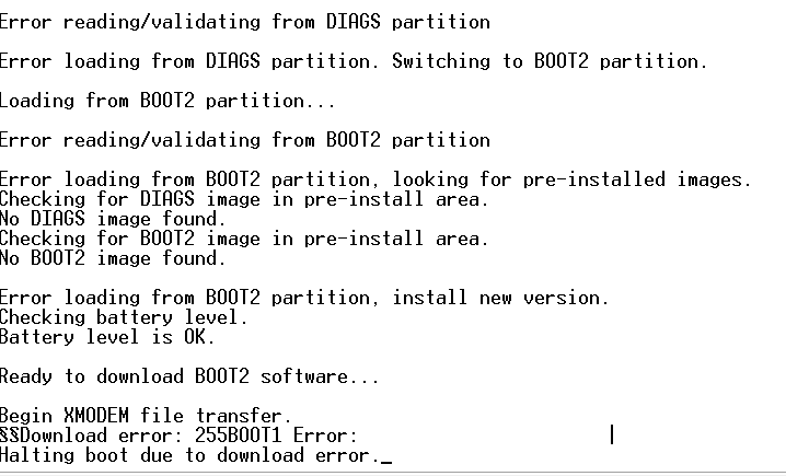

换了个终端,除这样的错误

Hi.
If the Boot2 transfer aborts between 1% and 99%, try to :
- secure the dock connections
- terminate as many background tasks on the computer as possible
发表于 2020-3-17 14:07:36 | 显示全部楼层
