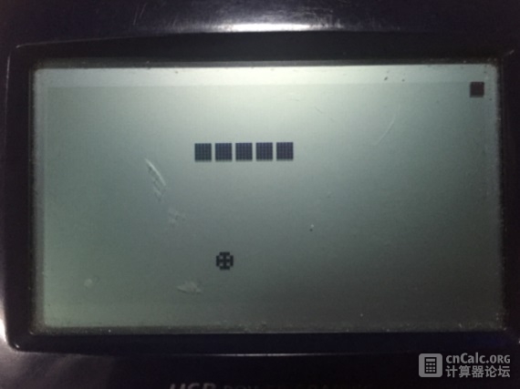

2.食物(f=0)
RanInt#(1,21)->M
RanInt#(1,7)->N
N+2->V
List V[M]=1=>Goto 0
1->F
Locate M,N,"⊙"
3.方向控制
4.是否吃到食物与是否撞墙
If List 1[T]=M And List 2[T]=N
Then Isz L
0->F
Locate P,Q,"■"
P->U
Q+2->V
1->List V[U]
Else Locate P,Q," "
P->U
Q+2->V
0->List V[U]
IfEnd
List 1[T]<1 Or List 1[T]>21 Or List 2[T]<1 Or List 2[T]>7=>Goto 0
Locate List 1[T],List 2[T],"■"
List 1[T]->U
List 2[T]+2->V
List V[U]=1=>Goto 0
1->List V[U]

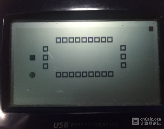

5.关卡
Level 1(Z.TCS1)
For 3->I To 9
21->Dim List I
Next
Level 2(Z.TCS2)
For 3->I To 9
21->Dim List I
Next
{0,0,0,0,1,1,1,1,1,1,1,1,1,1,1,1,1,0,0,0,0}->List 6
Level 3(Z.TCS3)
21->Dim List 3
{0,0,0,0,0,0,1,1,1,1,1,1,1,1,1,0,0,0,0,0,0}->List 4
{0,0,0,0,1,0,0,0,0,0,0,0,0,0,0,0,1,0,0,0,0}->List 5
{0,0,0,0,1,0,0,0,0,0,0,0,0,0,0,0,1,0,0,0,0}->List 6
{0,0,0,0,1,0,0,0,0,0,0,0,0,0,0,0,1,0,0,0,0}->List 7
{0,0,0,0,0,0,1,1,1,1,1,1,1,1,1,0,0,0,0,0,0}->List 8
21->Dim List 9
Level 4(Z.TCS4)
21->Dim List 3
{0,0,0,0,0,0,1,1,1,1,0,1,1,1,1,0,0,0,0,0,0}->List 4
{0,0,0,0,1,0,1,1,1,1,0,1,1,1,1,0,1,0,0,0,0}->List 6
{0,0,0,0,0,0,1,1,1,1,0,1,1,1,1,0,0,0,0,0,0}->List 8
21->Dim List 9
选择
O=1=>Prog "Z.TCS1"
O=2=>Prog "Z.TCS2"
O=3=>Prog "Z.TCS3"
O=4=>Prog "Z.TCS4"

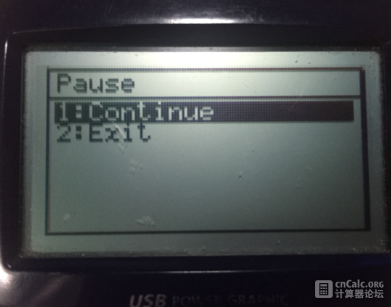

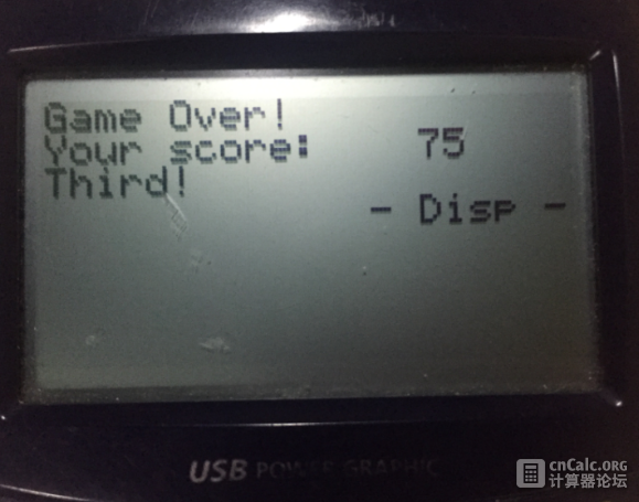

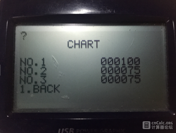

贪吃蛇5
贪吃蛇5
贪吃蛇4
贪吃蛇4
贪吃蛇3
贪吃蛇3
贪吃蛇2
贪吃蛇2
贪吃蛇1
贪吃蛇1
