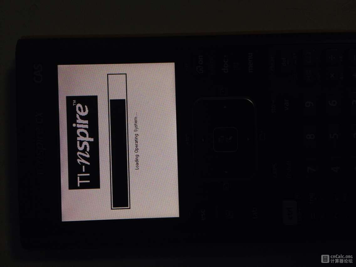

Hi,
Today, my friend robbed my CX CAS and opened 'nsNandMgr' , which i used to downgrade to OS 3.6, however, when my calculator come back to my hand, it stuck at diagnosis mode. So i pressed reset, and it rebooted to Diagnosis Mode, i know he must 'switch BOOT2 AND DIAG' in the BootD AREA. So in the diagnosis mode, i pressed '0' '1' which is 'Switch to OS Mode' ,and i pressed reset again , it started booting.
Then the booting UI turned into this (showed in picture)
What i had tried are :reinstalled the OS , Clear boot2 and flash boot2 again. These are all useless.
So how to change the LAUNCHING  ANIMATION back to it used to be?
Thank you.

发表于 2016-1-11 23:12:22 | 显示全部楼层
我也见过这个现象。我有个同学的Nspire的开机页面也是这样的,同求原因。
发表于 2016-1-12 16:26:35 | 显示全部楼层
我估计是manuf区块被破坏了。这个分区被破坏了之后不好还原的
KARMTI就是因为没有完整的manuf区块所以开机界面也是这个鬼样子
这是我从自己的L版Nspire CX CAS dump出来的manuf区块数据,不确定能否用nsNandMgr刷入其它Nspire CX (CAS)
(注:刷完之后可能会变成CX-C CAS,模拟器测试结果)
manuf.img.tns (128 KB, 下载次数: 51)
 楼主| 发表于 2016-1-12 18:42:40 | 显示全部楼层
KARMTI就是因为没有完整的manuf区块所以开机 ...
成功了!谢谢。
