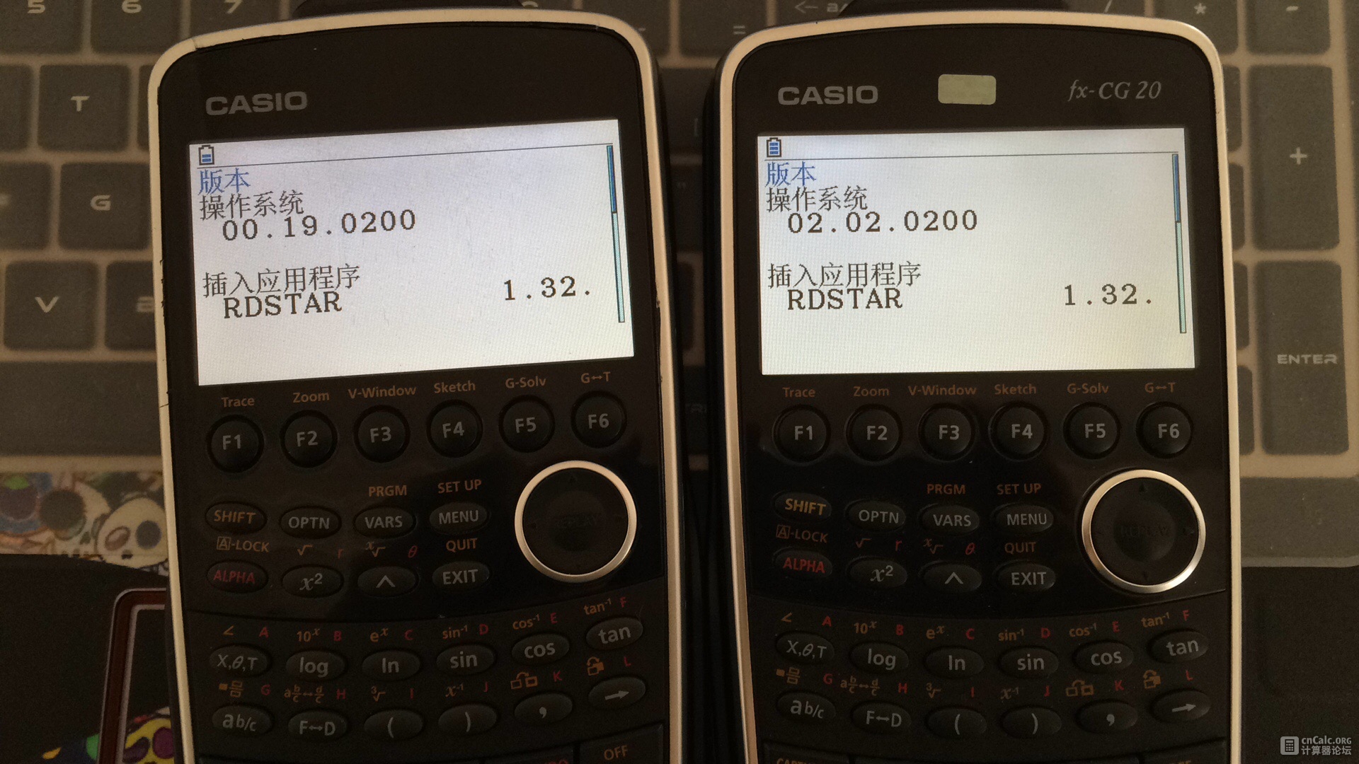

手上有一台10年的卡西欧cg20是卡西欧内部学习用的。操作系统是00.19.0200
楼主想更新操作系统,结果发现win64的电脑系统 连接不上,然后 win32的连接一次后,消失。
昨晚 用朋友家的XP系统,连接上了。但是系统更新不了啊 ……
小伙伴们,怎么弄啊!难道是我哪儿出错了吗。
另有一台卡西欧CG20.爆屏了。求吧友闲置屏幕!
左边的是卡西欧内部机,机头没有型号标示。右边为刚入手的CG20

卡西欧工程机真是少见……如果不影响用还是保留原系统吧,每台工程机多少都有点差别
如果需要升级的话,按照德仪工程机的思路是用最老版本的连接软件。不过一些工程机由于开发过程中硬件改变,升级不到量产机系统

Nice find.
Casio prototypes are really rare compared to TI ones.
Before upgrading it, it would be very interesting to dump OS 0.19.
(even for you : to be able to repair the calculator if the upgrade does fail, to figure out how to patch upgrade files if there are hardware differences...)
There is an add-in for dumping, Insight, with an how-to dump post there :
https://www.cemetech.net/forum/viewtopic.php?p=210673#210673
But unfortunately, all public links to the add-in I've found up to now seem to be broken. Let's wait...
Even if the USB doesn't work for now, you should still be able to send the Isight add-in from another calculator using the serial cable.
By the way, we don't even know if this calculator does support add-ins.
Could we have more pictures and informations about it ?
- pictures of screens which are different
- list of preloaded add-ins and of their versions
- storage memory capacity and free space
- pictures of the PCB
Something which could be done for now, is saving the add-ins if present.
- Send then add-ins to another calculator using the serial cable.
- From that other calculator, send them to the computer and share.
We'll then be able to check if the Insight add-in might need to be patched or not.
