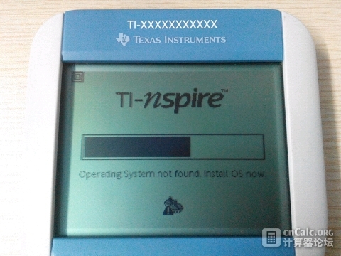

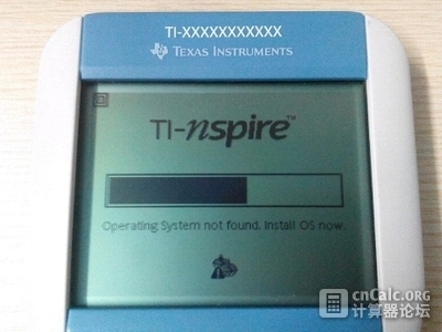

如题,今天从晴明那里买下了一台没有系统的TI-XXXXXXXXXXX,原先是有系统的,但是后来被晴明误删了。。。。
据晴明说,这台TI-XXXXXXXXXXX在电脑上可以被一些联机软件识别出来,但是却没有合适的系统,我想问问各位大神,有没有TI-XXXXXXXXXXX的系统@549597890 @ZephRay @朔雪X忆

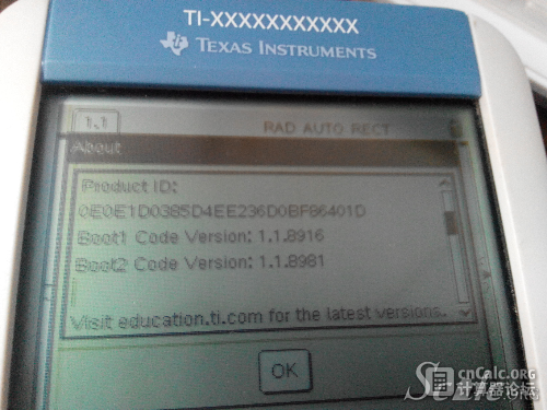

 楼主| 发表于 2015-5-11 18:41:03 | 显示全部楼层

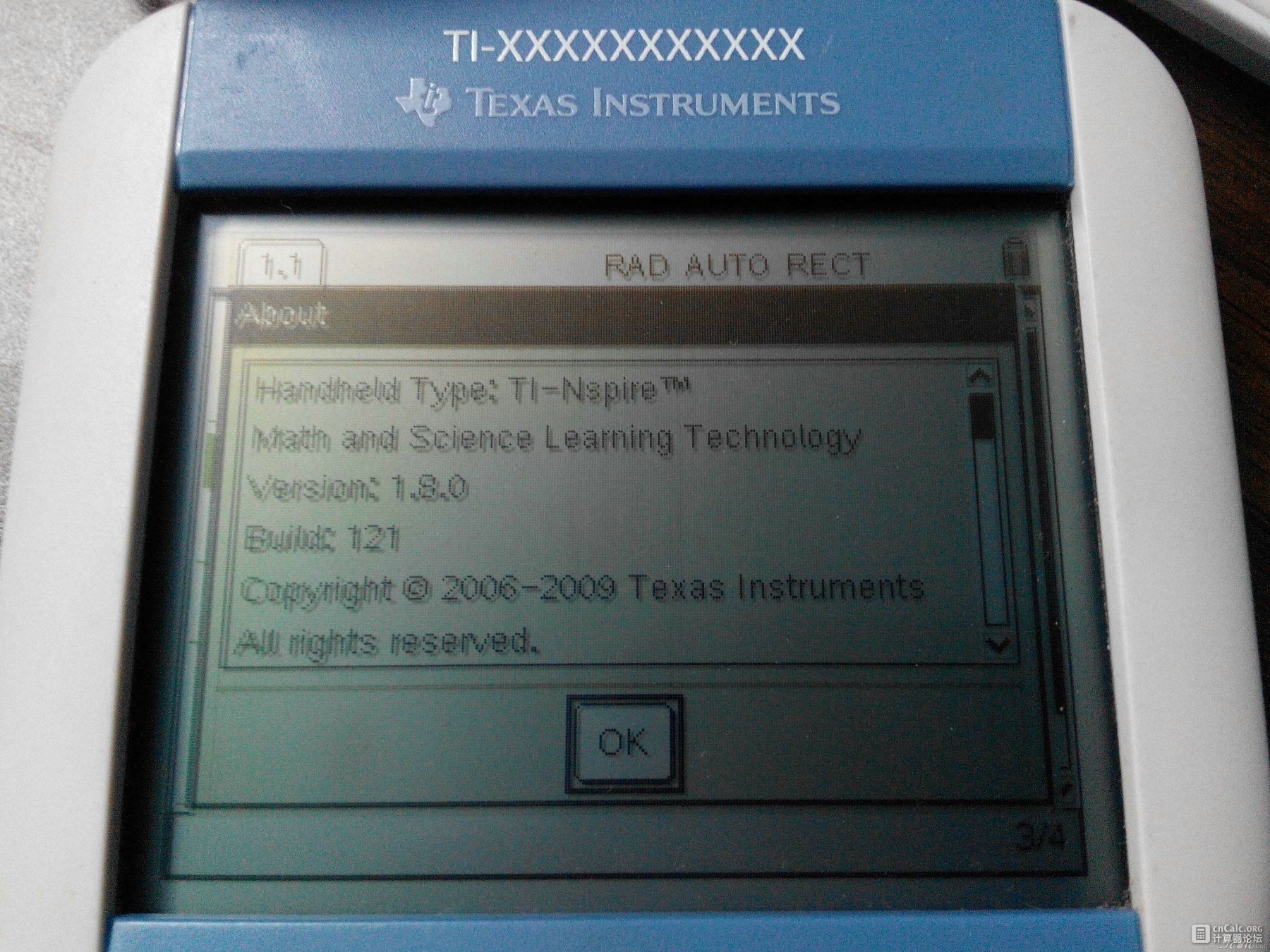

这是系统没删除之前的图片
This is a photo before delete system

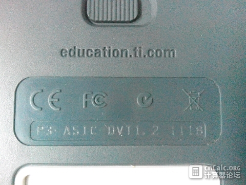

发表于 2015-5-12 01:00:25 | 显示全部楼层
我以前会刷, 参考我以前发过的 NS工程机刷机贴, 国外这种TI-xxx的刷机成功率说是100%
发表于 2015-5-12 03:14:45 | 显示全部楼层
Hi,
You should be able to install OS 2.0.0.717 :
https://tiplanet.org/forum/archives_voir.php?id=64653

这种TI-XXXXXXXXXX没有CAS,是不是直接安装系统就行了?
发表于 2015-5-13 03:11:36 | 显示全部楼层
461065836 发表于 2015-5-12 12:15
Thanks very much!!!And can it ndless?
No Ndless version has been specifically designed for OS 2.0.0.717 to my knowledge.
You can still try Ndless 2.0. Maybe it'll work.

现在TI-XXXXXXXXXXX已经升级到2.0的工程机系统了,还可以降回去吗?
那TI-XXXXXXXXXXX可以利用ndless刷成量产机吗?我找了TI星球,但是没有找到合适的ndless
发表于 2015-5-13 16:39:21 | 显示全部楼层
Then, someone has to disassemble OS 2.0.0.717, take Ndless 2.0 sources, and update the syscalls adresses list.

发表于 2015-5-14 11:24:49 | 显示全部楼层
那TI-XXXXXXXXXXX可以利用ndless刷 ...
可以降级, 能刷成量产机, 我已经刷了3台了
发表于 2015-5-14 17:36:31 | 显示全部楼层
Modding your prototype into a production model accepting all production OS up to version 3.3 is possible.
Note that versions 3.6 and later do not work properly on your prototype - they just freeze at startup - and it's a problem as they try to prevent you from downgrading once installed.
You need to flash a production Boot1, and a production Boot2.
In order to flash those images, you need to have Ndless.
In order to have Ndless, you need to install a non-CAS prototype OS for which it is available - 1.1.9227 is the only choice to my knowledge : http://tiplanet.org/forum/archives_voir.php?id=2205
If you manage to install that OS, a french tutorial is available :
https://tiplanet.org/forum/archives_voir.php?id=4237
