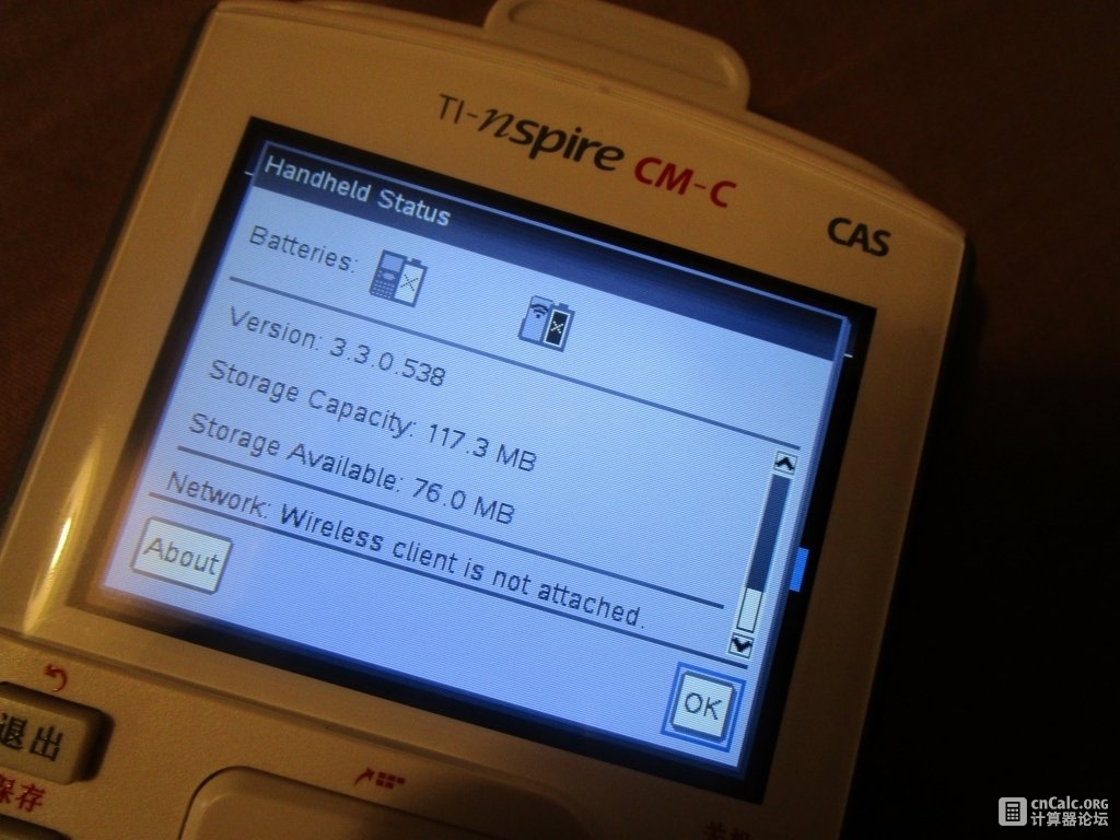

Hi guys and specially TI-Nspire CM owners.
TI stopped updating TI-Nspire CM OSes with version 3.2.0.1219 almost three years ago.
Meaning that you can't open many recent TI-Nspire documents.
Fortunately, we've now updated nsNandMgr to allow modding of TI-Nspire CM into TI-Nspire CX in a more secure way.
Moreover, we have also updated Nlaunch CXM with support for more recent OSes.
As a result, you can at last update your TI-Nspire CM using a TI-Nspire CX OS up to version 3.2.4 or 3.3 !
And you can still install a TI-Nspire CX CAS OS on a non-CAS TI-Nspire CM.
More recent versions like 3.6 although supported by Nlaunch CXM don't work. They fail with the same symptoms as when you try to run a 3.6 CAS OS on a non-CAS calculator.
Tutorials in both french and english as well as updated tools are linked from the TI-Planet news - have fun bringing your TI-Nspire CM back to life !
http://tiplanet.org/forum/viewtopic.php?t=16100&p=178025#p178025

Sounds good. However, if I wanna use ndless I must install 3.1.
 楼主| 发表于 2015-2-25 17:37:13 | 显示全部楼层
Right.
But you can install one of our switching packs to have two OSes on your TI-Nspire CM :
http://tiplanet.org/forum/viewtopic.php?f=57&t=16096
When you need to run Ndless programs, you switch to OS 3.1.
When you want to use Lua documents, you switch to OS 3.2/3.3.
