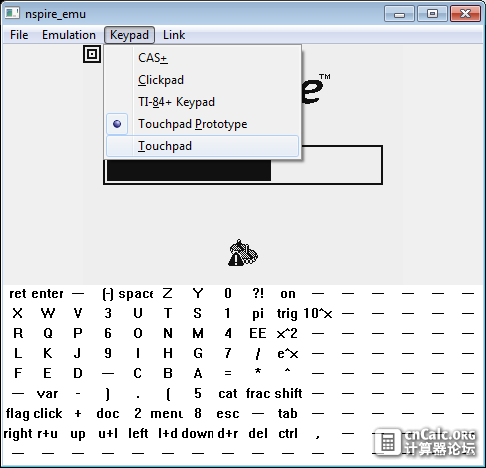

when  you update your TP PVT, you lose ervery arrow
yet you still have other keys
the PVT TP's  key
the key code stand  for
esc
esc
scratchpad
tab
tab
on
on
doc
home
menu
menu
ctrl
ctrl
shift
del
var
catalog
del
shift
sin
tri
exp()
^2
EE
exp()
^2
10^
pi
matrix and  more
d
catalog
var
h
l
c
g
enter
enter
1
1
2
b
3
3
4
4
5
e
6
6
7
7
8
a
9
9
0
0
f
ee
p
a
i
b
cos
c
j
d
k
e
j
f
g
m
h
8
i
n
j
o
k
l
m
q
n
5
o
r
p
s
q
r
s
u
t
2
u
v
v
w
w
x
y
y
z
blank  space
z
x
flag - input
flag - input?: not  sure
newline
newline
@critor
with the help of this work done by me, i successfully use the mad tp PVT and downgrage
用这些,足够降级了。

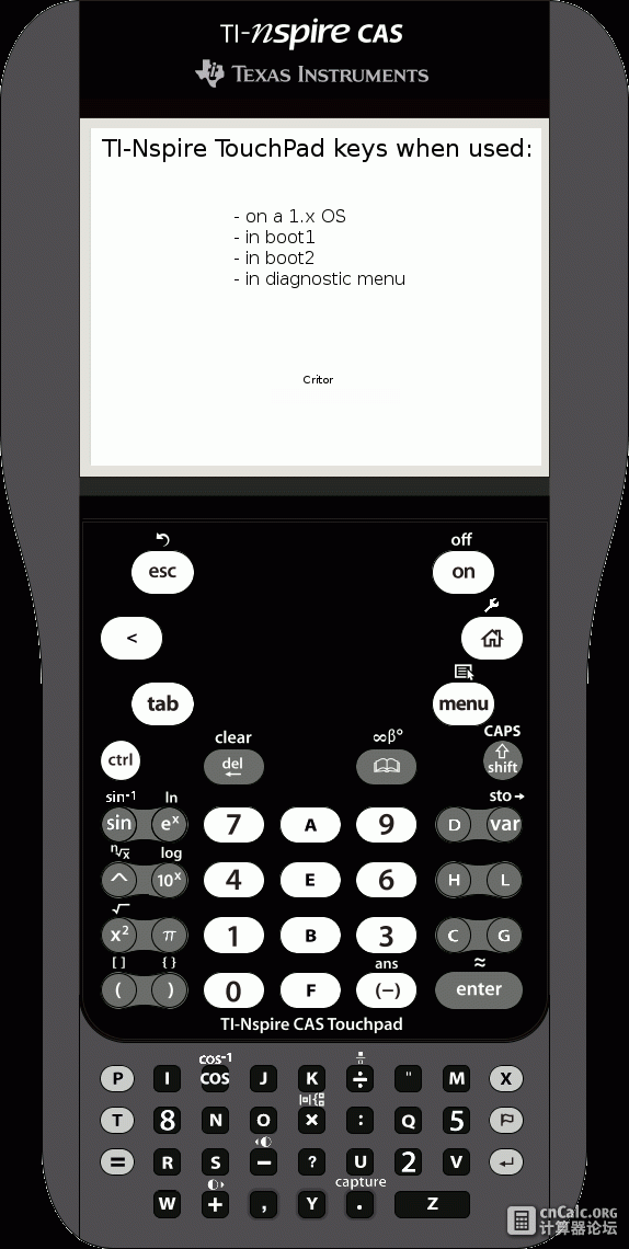

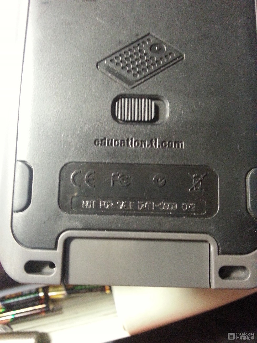

Note for the keypad problems.
You should try to replace your prototype/DVT keypad with a production keypad, and see if the problem does persist.
Prototype/DVT touchpad keypads are supported separately from production touchpad keypads in our TI-Nspire emulator.
发表于 2014-4-6 17:27:43 | 显示全部楼层
By the way, here is the production TouchPad keypad in ClickPad mode (used with OS 1.x):
If the prototype TouchPad keypad is not too different, you should get something similar.
