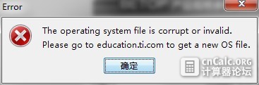

I bought the NSPIRE non-cas,but I found out that I can't update the OS.
The native verison is 1.1.x,but I can't remember the excat verison.
If I try to update the OS,I will see the error like that.
English for @ciritor

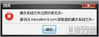

I think it will be the matter about the native OS, so I "home+p+enter" to formal my nspire。{:shocked:}{:shocked:}
It is nothing difference between my delete opreation.ERROR“os file is corrupt or invalid”(“操作系统文件已损坏或无效”).

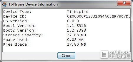

device information:

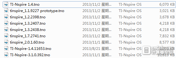

I tried many OSs.
Those are the OSs what I've tried...No one can bring me success.
it's the list: QQ拼音截图未命名.png

发表于 2013-11-3 01:47:20 | 显示全部楼层
Hi,
You've got a prototype which is set to accept only development images, as we can see with the symbol in the top left-hand corner of the boot screen:
So it's going to reject all production images available on education.ti.com.
But don't worry, it's possible to modify it through software into a production model and to upgrade it up to OS 3.2!{:thumbsup:}
First, we have to make it usable again. Please install development OS 1.1.9227. It should work without any problem. :)

1. 装 1.3版  Computer Link软件(1.0太低, 等下没法刷ndless, 太高的版本有的认不出工程机器)
2. 刷工程机专用OS, no-cas用1.1.9227版, CAS用1.2.2344版, 这是为了方便等下刷ndless
(让我比较在意的是你的BOOT2版本是 1.2.2398,这个不像工程机的BOOT2,我下载回来的若干工程机BOOT2全部是 1.1.x的), 如果此步不成功, 可能要USB/TTL刷BOOT2, 刷个1.1.9170工程机版的BOOT2吧.
