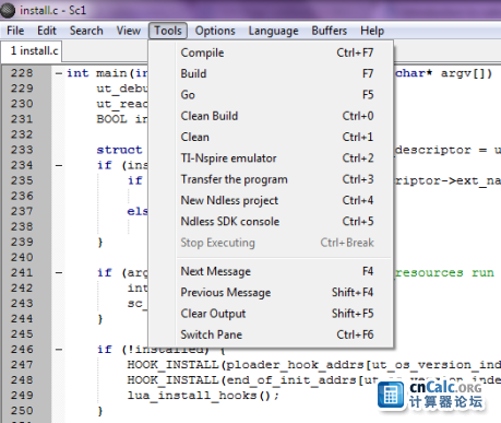

Ndless编辑器
Ndless编辑器是一个基于SciTE的文本编辑器,但是经过了配置和扩展,使他十分适合用来编写C语言程序。
打开SDK根目录下的 NdlessEditor.exe
和Ndless有关的命令在 Tools 菜单下。运行命令时,相关消息会显示在屏幕下方。

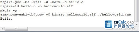

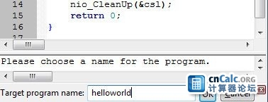

编译
使用 Tools > Build (或者按下F7)来编译程序。第一次编译时必须给程序命名。Type ‘helloworld’ in the at the bottom of the editor, and press enter. This will be the name of the generated .tns.
A Makefile is created in the program’s directory. If you want to change the name of the program later, you’ll be able to edit the Makefile and change the EXE variable.
The build commands result are displayed in the message pane. If you get an error, double check the source code of the program.

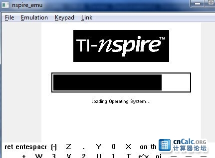

Emulating
Testing the first versions of your program with the emulator may be faster than transferring them after each build to a real TI-Nspire. Let’s run the TI-Nspire emulator with the Tools > TI-Nspire emulator command. Wait for a few seconds until the OS is fully loaded.
If you have any issue here, make sure you have followed every step described in emu_resources/_ReadMe.txt of the Ndless SDK.

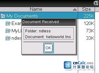

We can now send the helloworld.tns file we have just built. In the Ndless Editor where hello.c is open, use the command Tools > Transfer the program. The program will be automatically sent to the ‘ndless’ directory of the TI-Nspire OS.
Finally let make it say hello to the world: open the ‘ndless’ directory in the emulator and open helloworld.tns. If a popup is displayed telling you that ‘This document format is not supported’, Ndless was not installed correctly. Follow again the instructions in emu_resources/_ReadMe.txt.
helloworld.tns is stored in the ‘hello/’ directory of the computer we have created at the beginning of the tutorial. What about trying it on your own TI-Nspire?
